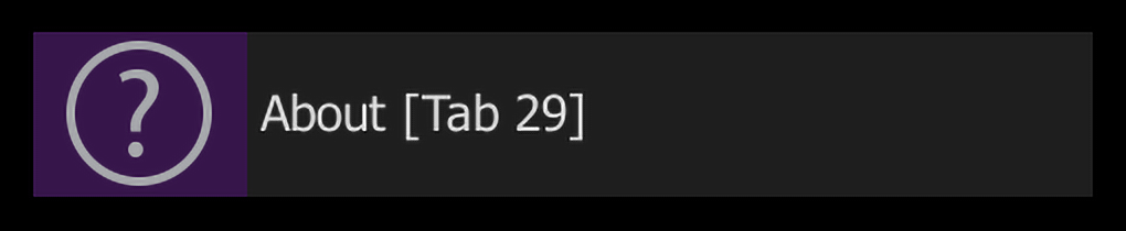

[About] [Tab 29]
The About display provides detailed information about selected elements of your show file.
About can be opened in a standalone tab from the Workspace Layout Menu or by using [Tab] & [2][9].
This display can also be accessed:
  • Using [About][About].
  • Via a connected keyboard with YY.
Pressing [About] opens About in the Central Information Area (CIA) below the The Command Line. In this mode, About will live update as show file elements are selected or changed, allowing you to examine information indefinitely while About remains open.
[About] and Display Toggles can be used to display additional information in Live and Blind.
